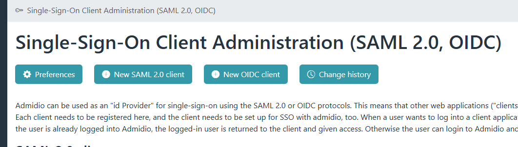

Now, return to Admidio's SSO preferences page, go to the “Single-Sign-On Client Administration” (the button right below the endpoint URLs and above the “Save” button), and create a new client.
