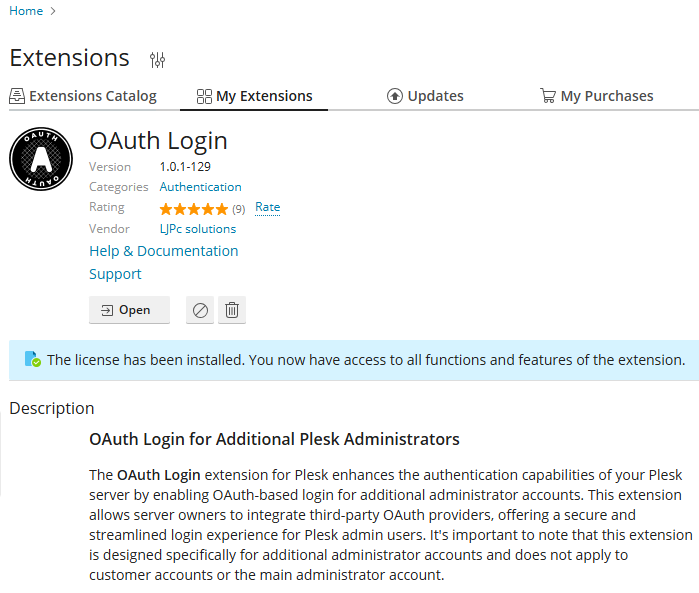

Plesk provides OpenID Connect login through the OAuth Login plugin. This is not a free plugin, but charges a yearly or monthly license fee. In this tutorial, we will describe how to set it up properly for single-sign on using Admido's user accounts.

First, install the OAuth Login plugin in Plesk from the plugin directory:

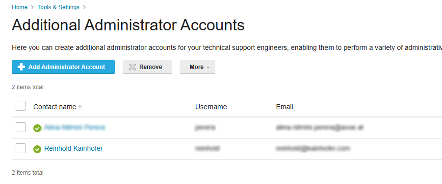

Setting up additional Administrator Accounts
OpenID Login in Plesk does not work for the main administrator, but only for “additional administrator acounts”. They can be set up as main administrator in the “Tools & Settings” area:
The email address will be used to match logins to existing additional admin accounts.
