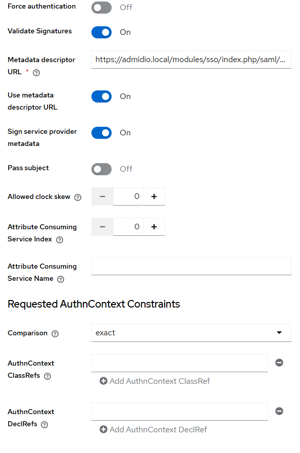

Keycloak supports auto-configuration, so copy the SAML Metadata URL from Admidio's preferences and paste it into the „SAML entity descriptor“ field. Keycloak will load the SAML IdP configuration from Admidio and populate all fields.
After clicking „Add“, the SAML Provider is saved in Keycloak and can be further configured.

It is also a good idea to require requests to be signed, and to sign all messages. Choose whichever level of security (request signing without requiring, require signing, or even encrypting all messages) fits you. You only need to ensure that the settings in Admidio and Keycloak are be consistent.
Keycloak also provides some more configuration settings that allow fine-tuning the SAML login behavior. The defaults should work fine, but changes can be made if other settings are prefered.

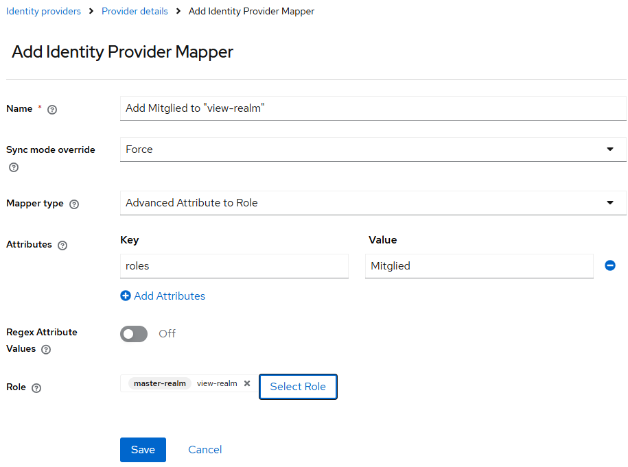

Keycloak's Mapper feature allows Admidio groups to both assign individual roles to a user, or assign the user to a particular group (which gives all permissions defined for that group). For this to work, clearly, Admidio must be configured to include the Admidio roles of a user as SAML attribute (typically called „roles“ or „groups“, but any other name will work, too, as long as the new name is properly used in Keycloaks mapper). Use either the „Advanced Attribute to Group“ or the „Advanced Attribute to Role“ Mapper type.
