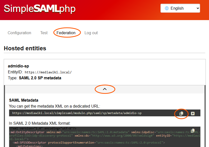

SimpleSAMLphp should now be set up to connect to Admidio. It provides metadata for automatic setup in the „Federation“ tab in the „Hosted entities“ section:
The link typically has the form https://[YOUR_INSTALLATION]/simplesaml/module.php/saml/sp/metadata/admidio-sp. Copy that URL to later paste it into Admidio.

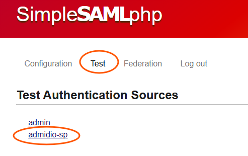

Admidio and SimpleSAMLphp should now be set up to use Admidio for logging in to SimpleSAMLphp. Switch back to the SimpleSAMLphp admin screen and go to the „Test“ tab. Click on „admidio-sp“ (the array key used in config/authsources.php for the Admidio IdP). You will be redirected to Admidio's login form.
After logging in with a user from Admidio, you should be logged in to SimpleSAMLphp.

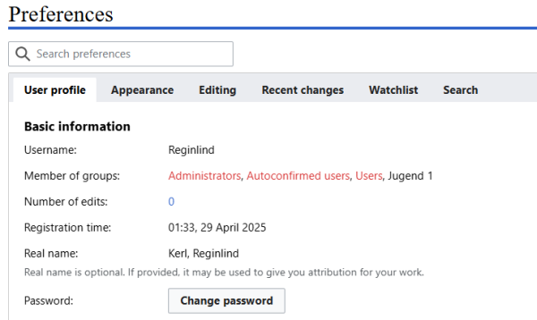

MediaWiki should now use the SAML login through the SimpleSAMLphp installation. Groups should be assigned as mapped in Admidio:
