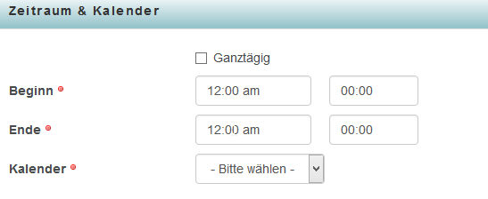

i think there is something going wrong. See screenshot or demo.
In date field is am until u click it.

When i want to create new event i got that
arning: preg_match(): Compilation failed: two named subpatterns have the same name at offset 88 in /www/htdocs/admlogin/demo/adm_program/system/classes/datetimeextended.php on line 263
Warning: Cannot modify header information - headers already sent by (output started at /www/htdocs/admlogin/demo/adm_program/system/classes/datetimeextended.php:263) in /www/htdocs/admlogin/demo/adm_program/system/classes/message.php on line 154
Hinweis
Es wurde keine gültige Uhrzeit in das Feld Uhrzeit Beginn eingegeben.
Die Uhrzeit muss dem folgenden Format H:i entsprechen.

Bullseye hat geschrieben:i think there is something going wrong. See screenshot or demo.
This was because you set g i:a in the date format field and not the time field.

fasse hat geschrieben:
Ah ok. But if u do that, an error mesage should thrown, that u are using wrong format
