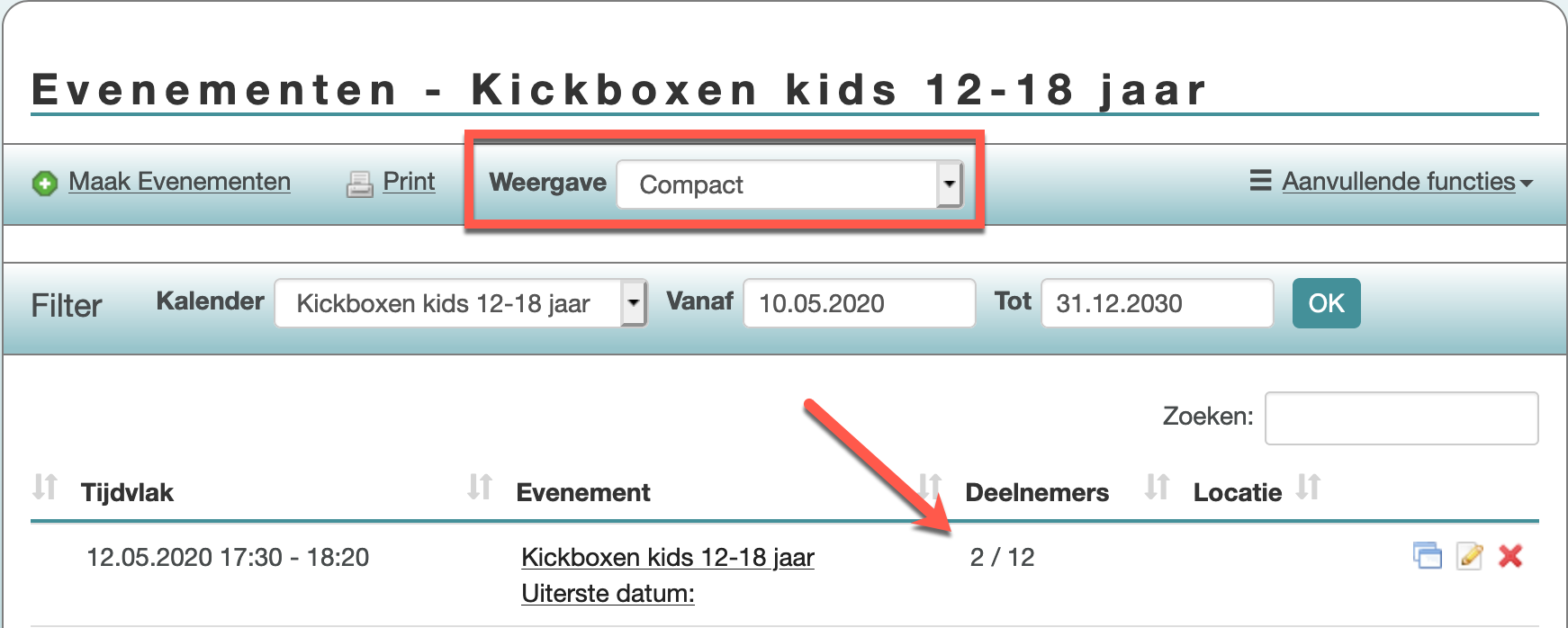

Sorry I'm dutch and not german, so I'll try to explain it in English.
We are trying to use your application and we stumbled on a strange thing.
When a participant subscribe to a event with limited room, you will see the number of participants with +1 and in de events overview you will see the participants name as administrator.
When a participant cancel's the subscribtion the subscribers number will be lowered with -1 as expected.
But... when we do the event overview with the participants, we still see there name as subscribed.
Can you help me with fixing this?
you can view the screenshots with the following links;
Image with participants number.
Image with event overview, where you see the subscribed as canceled participants
Canceled participants show up in overview

Re: Canceled participants show up in overview
When a member subscribe to a event with the option Participate, in the Detailed view you wil see that the members will upper with +1 members.
If you look in the Compact - Members view you will see the name of the member(s) which pariticpate to a event.
Then the member logs in and then cancels his participation the Members number in the overview will lower with -1 members.
But, when you go to the view Compact - Members you still will see the participant name at the event, even when the Members number is 0.
When a member even just only cancel his participation, his name is added.
- Here you see names, even with 0 members
- Admidio2.png (196.66 KiB) 14183 mal betrachtet
- Here you see 0 members
- Admidio1.png (203.51 KiB) 14183 mal betrachtet
