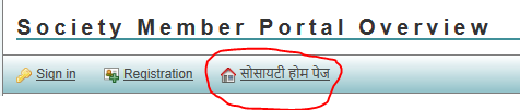

Hello VolkerF,
I added below line in else section of /adm_program/index.php to get the link. Give it a try..
$mainMenu->addItem(
            '', 'https://www.mysociety.com/','सोसायटी होम पेज','home.png'
LInk on HomePage.PNG (8.09 KiB) 13794 mal betrachtet
Its also documented at FAQ Question no - 15 at https://www.admidio.org/dokuwiki/doku.php?id=en:2.0:faq
Hope it helps.
Thanks,
Amitabh

Ok, es funktioniert jetzt - vielen Dank. Ich hatte die Klammer vergessen Gruß Volker
