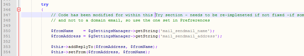

Hi there
The code in email.php in adm_programs/system/classes will expose the members address if they try to reply to an email, they receive even though it says “No Reply@xxxxx.xx”. This may be fixed in a future release. However, until that time, a temporary change in the code has been made and must be replicated into the program subsequent to an upgrade. The code in email.php should look like that shown below, starting at or around line 347.
// Code has been modified for within this Try section - needs to be re-implemented if not fixed ……
// and not to a domain email, so use the one set in Preferences
$fromName = $gSettingsManager -> getString('mail_sendmail_name');
$fromAddress = $gSettingsManager -> getString('mail_sendmail_address');
$this -> addReplyTo($fromAddress, $fromName);
$this -> setFrom($fromAddress, $fromName);
I hope this works for you
Bryan
Bryan
- Email Code Fix.png (12.94 KiB) 22945 mal betrachtet
