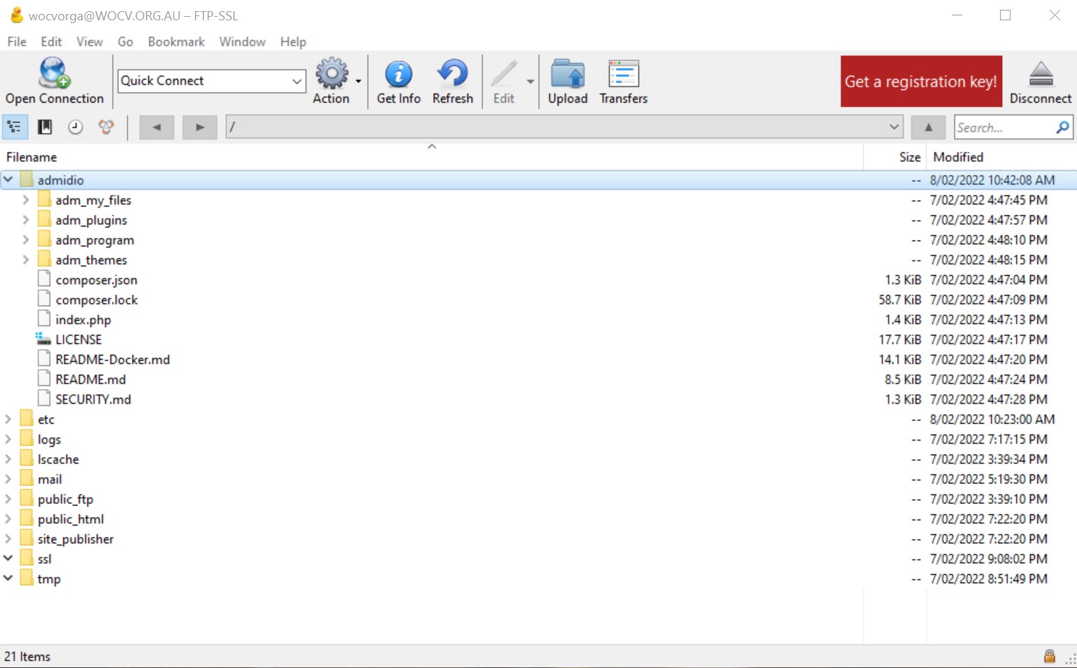

I've followed Steps 1 and 2 in the installation guide - downloaded the app and unzipped, and copied the files to the server (which took a marathon 8+ hours over my pathetic satellite connection :cry: ) and changed the folder privileges as instructed.
Now I'm at step 3 - I try to navigate to https://www.wocv.org.au/admidio/index.php via the browser to run the installer script and all I get is a 404 error "The resource requested could not be found on this server!"
This is the server directory listing:
Screenshot 2022-02-08 104507.PNG.jpg (166.74 KiB) 14305 mal betrachtet
I can go no further with the install. What's the solution please?

This has been solved by the discovery of another forum post that gave me a clue. Perhaps you could update the installation instructions to tell newbies to copy the admidio folder to /public_html.
There is also a basic flaw in the unzip folder process as it creates an admidio/admidio folder and until I moved all the files up one level on the server it wouldn't work either.

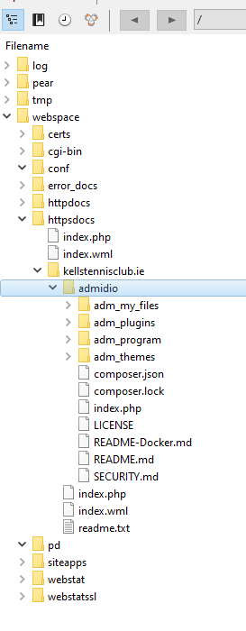

This is now driving me crazy.
I have indeed as suggested adjusted the file structure to not have a admidio/admidio folder . Followed instructions to the letter, set correct permissions, but simply don't get to installer
I only get "Page not found" when calling for https://kellstennisclub.ie/admidio/index.php
Also can't call install dialog directly thru https://kellstennisclub.ie/admidio/adm_ ... /index.php
Moved folders to both httpdocs and tried http://kellstennisclub.ie/admidio/index.php , but same result.
Any idea what I am doing wrong ??

Have you tried to Open other webpages within your webspace? Is it only admidio that would Not find pages or other applications too?
