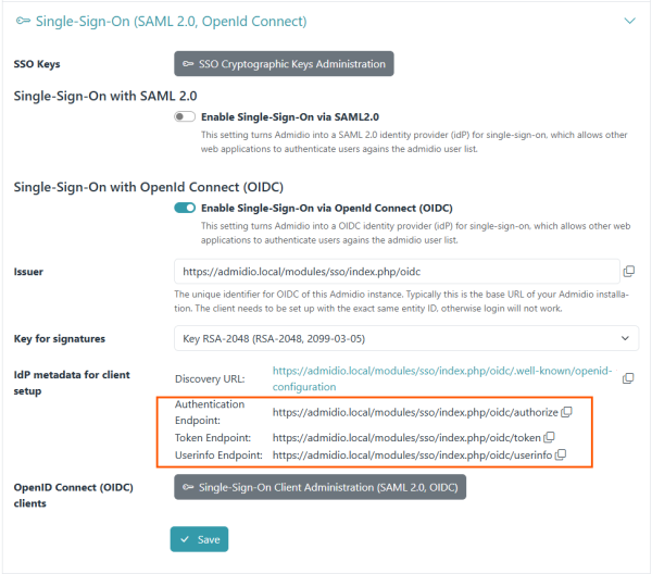

First, one has to copy over the OpenID endpoint URLs from Admidio's OpenID preferences (each URL has a copy button). You can find them here:
It is now a good idea to keep two browser windows open so one can easily select and copy the settings. Admidio even provides little „copy“ buttons/icons to copy the various settings to the clipboard for easy pasting into DokuWiki's configuration.
