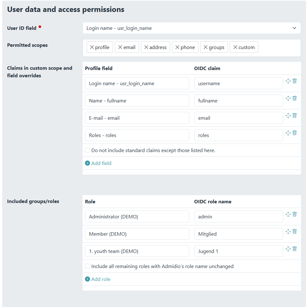

Now, return to Admidio's SSO preferences page, go to the „Single-Sign-On Client Administration“ (the button right below the endpoint URLs and above the „Save“ button), and create a new client.
  1. The Client Name is the label of the client in Admidio's client list, it can be anything you like.
  2. The „Client ID“ and „Client Secret“ in Admidio have to match exactly the „clientID“ and „clientsecret“ entries in GitLab's configuration. The ID is typically the client's URL, i.e. https://[YOUR_GITLAB]/. The client secret is randomly generated and must be copied exactly to the GitLab configuration, as it will serve like a password. Admidio will create one and allow it to be copied to the client. Afterwards it is only stored as a hash in the database and can not be recovered any more. However, one can create a new Client Secret in Admidio and copy that to the client's configuration.
  3. GitLab's redirect URL is the Special:PluggableAuthLogin page, i.e. https://[YOUR_INSTALLATION]/index.php/Special:PluggableAuthLogin. Enter that URL in Admidio's client config.
  4. Enter the scopes you used in GitLab's config and make sure that Admidio's config matches it. At least openid must be included (Admidio will implicitly add it). If groups/roles are supposed to be used for access permissions, the „groups“ scope also must be included in both GitLab's and Admidio's scope setting and the roles included as an OpenID claim. (The groups mapping that Admidio offers is optional, one can also send all groups verbatim without mapping. This can be achieved by checking the checkbox below the mapping table in Admidio).
This is a typical configuration of the GitLab OpenID client in Admidio:
The clientID and the client secret in the Admidio client page and GitLab's config/gitlab.rb have to match exactly. Similarly, the scopes should coincide, otherwise not all desired profile fields will be transmitted. To make use of the group mapping in GitLab (see the Gitlab documentation for details), make sure to include the 'groups' scope in Admidio and GitLab, and map the 'Roles - roles' Profile Field to an OIDC claim.
