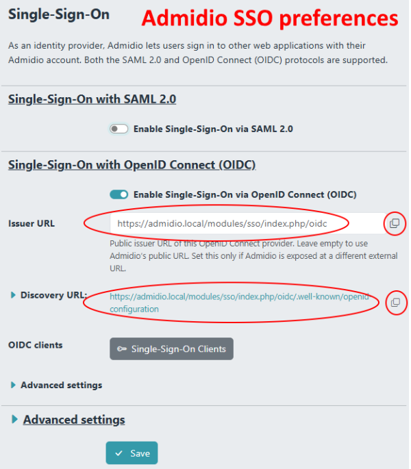

  1. The client (RP, GitLab in our case) needs to be set up with the data about the OpenID Provider (OP). Typically this is done via the metadata provided in the discovery URL of the provider. Otherwise one has to manually paste the endpoint URLs of the OpenID provider. Since Admidio provides those URLs with copy buttons in the preferences screen, even the manual configuration is rather straightforward.

    • Copy the issuer URL (the base for all endpoints, including the discovery URL) into the 'issuer' setting

    • The issuer key is the base URL for the endpoints, without the endpoint names themselves. One has to copy over the OpenID Issuer from Admidio's OpenID preferences (it has a copy button).

It is now a good idea to keep two browser windows open so one can easily select and copy the settings. Admidio even provides little “copy” buttons/icons to copy the various settings to the clipboard for easy pasting into GitLab's configuration.
Now, return to Admidio's SSO preferences page, go to the “Single-Sign-On Client Administration” (the button right below the endpoint URLs and above the “Save” button), and create a new client.
