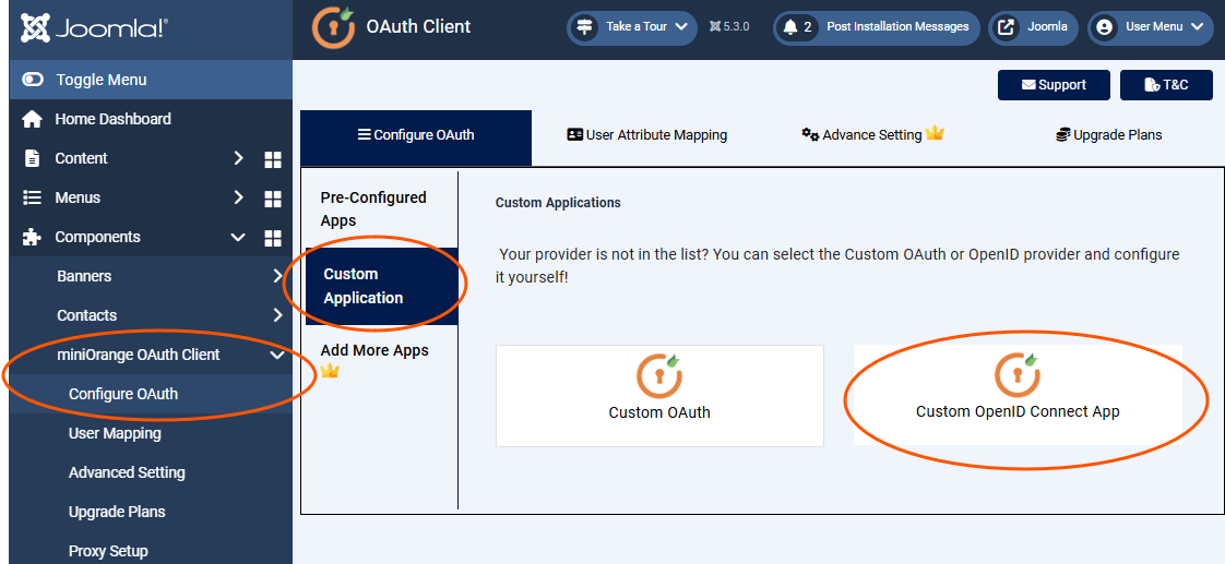

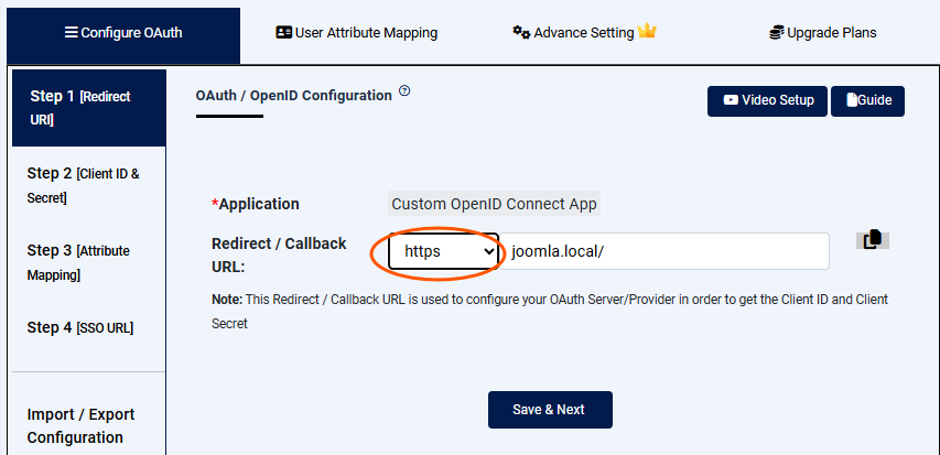

Configure the plugin in Joomla's Administration area in the menu section “Components” → “miniOrange OAuth Client” → “Configure OAuth”.
  • First, create a new connection to Admidio via the “Custom Application” button:
  • Select https for the redirect URL and copy the URL (we will paste it into Admidio's configuration):

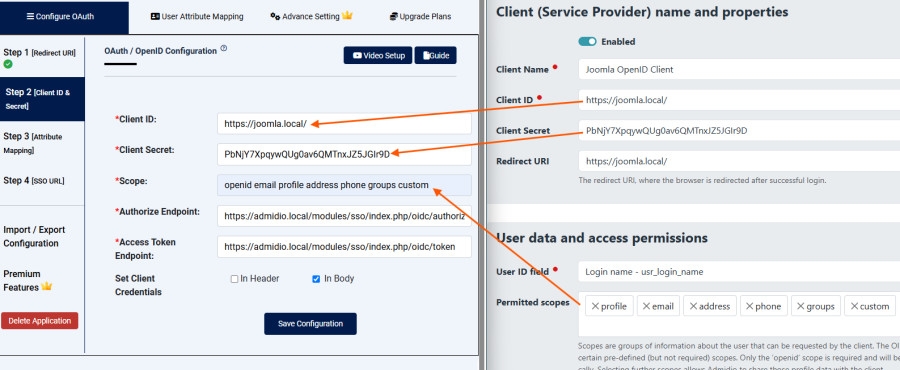

  • For step 2, return to Admidio's SSO preferences and copy the URLs for the Authorization and Token endpoints from Admidio to Joomla's plugin conf.
  • The other fields in step 2 will be filled after a new OpenID client is created in Admidio in the next section.

  • The Client Name is the label of the client in Admidio's client list, it can be anything you like. It will be shown to the users in the headline of the login form.
  • The “Client ID” is used to uniquely identify the Joomla installation when a login request is received by Admidio. In principle, it can be any unique identifier, but it is customary to use the base URL of the installation. Just make sure that exactly the same Client ID is used in Joomla and Admidio (even trailing slashes have to match exactly!).
  • The Client Secret should be a random string and will serve like a password. Admidio will create one and allow it to be copied to the client. Afterwards it is only stored as a hash in the database and not be recovered any more. However, one can create a new Client Secret in Admidio and copy that to the client's configuration.
  • The “Redirect URL” in Admidio's config should be the Redirect / Callback URL of Step 1 of the Joomla configuration (typically https://[YOUR_INSTALLATION])
  • Enter the scopes you desire in Joomla's config and make sure that Admidio's config matches them. At least openid must be included (Admidio will implicitly add it). As the free plugin does not support advanced fields mapping or group mappin, only the “email” and “profile” scopes are relevant and should be selected (otherwise the email and username will not be sent to Joomla).

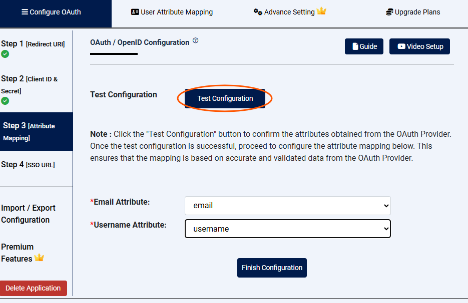

After saving the settings both in Admidio and Joomla, the Joomla plugin is ready for a test run and the final touches of the configuration:

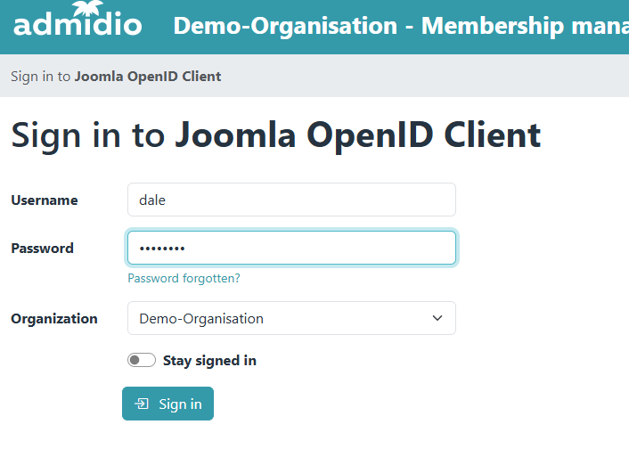

  • First, you MUST test the configuration. This will redirect you to a login form in Admidio, and after a successful login back to Joomla, where the data provided by Admidio will be displayed together with a success message. If anything was wrongly configured, a corresponding error message will be triggered.
  • Once this initial connection test is successful, the last setting is the mapping of the email and username in the lower half of the form of Step 3 in Joomla.
After saving, the configuration of the OpenID plugin is finished.

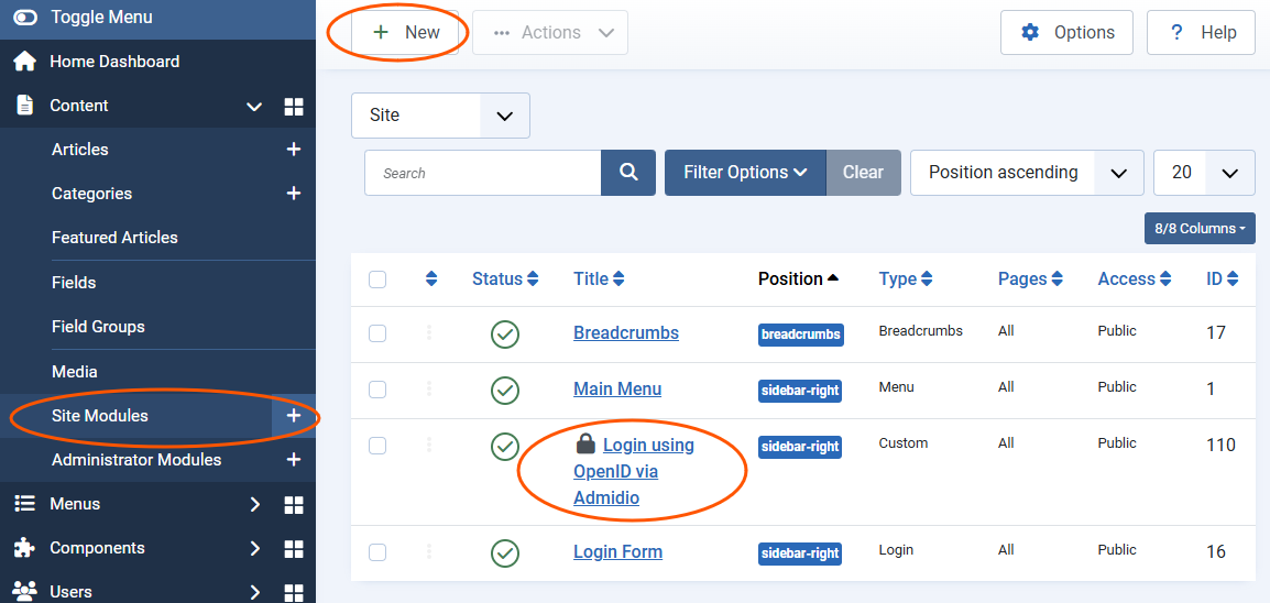

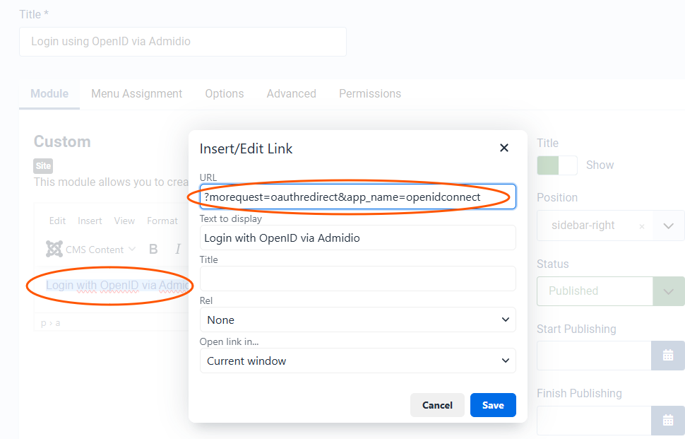

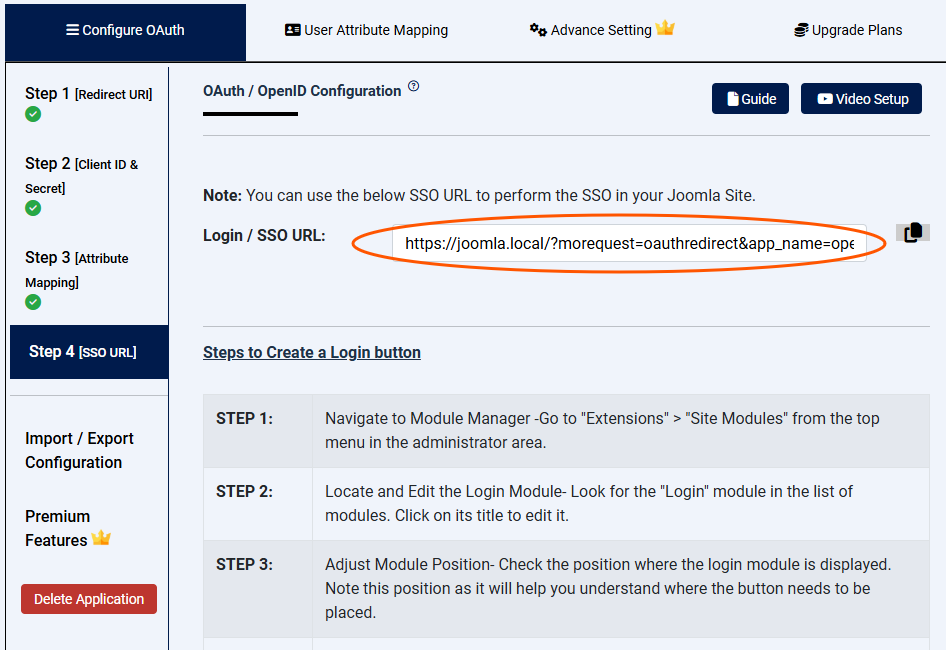

Although the plugin configuration is finished, the plugin does not automatically replace Joomla's login form with the OpenID login link, which is shown in Step 4. Rather, one has to create a custom Joomla module or menu item that uses the provided login link as target.
  • Either create a new custom module (“Content” → “Site Modules” → “+ New” → “Custom Module”) and create a link with the URL shown in Step 4.

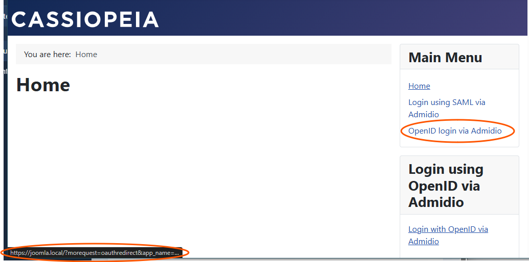

  • Alternatively, you can also insert a new menu item with item type “System Links” → “URL”. Let this menu item again point to the Login URL shown in Step 4

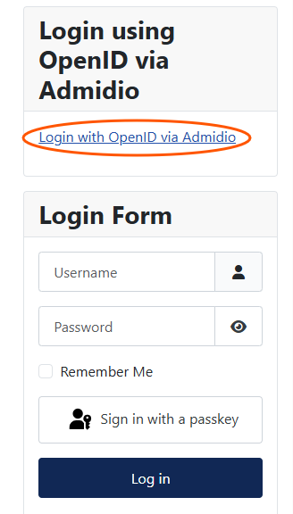

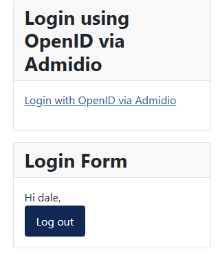

You should now have login links on your page.
Admidio and Joomla should now be set up to use Admidio for logging in to Joomla. The normal Joomla login form will still be shown and does NOT redirect to Admidio for login. Rather, it can be used for login with local Joomla accounts, which still can exist in addition to OpenID (or SAML) SSO.
If you log out of Joomla and try to log in again, you will be shown the Admidio login screen and then redirected back to Joomla.
