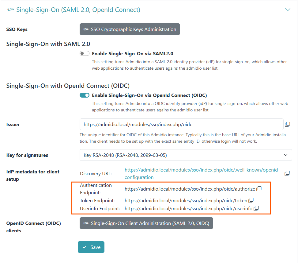

    • One has to copy over the OpenID endpoint URLs from Admidio's OpenID preferences (each URL has a copy button). You can find them here:
    • The 'providerURL' is the base URL of your admidio installation, i.e. the path to any of the endpoints shown in Admidio without the final authorize, token or userinfo
    • The Client ID and Client Secret will later come from Admidio's client configuration.

It is now a good idea to keep two browser windows open so one can easily select and copy the settings. Admidio even provides little “copy” buttons/icons to copy the various settings to the clipboard for easy pasting into MediaWiki's configuration.

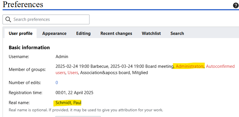

To assign admin (sysop) rights to an OpenID account, the group 'sysop' should be assigned in Admidio's client config and MediaWiki's groupsyncs must exclude 'sysop' from the locally managed groups.

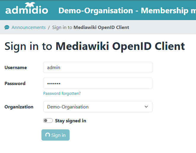

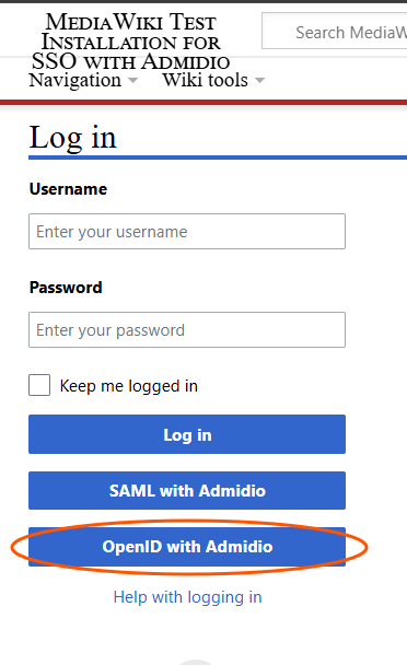

Admidio and MediaWiki should now be set up to use Admidio for logging in to MediaWiki. If you log out of MediaWiki (or open a new incognito browser window) and try to log in again, you will be shown the Admidio login screen and then redirected back to MediaWiki after successful login. If groups are properly set up and mapped, MediaWiki groups will also be assigned, even admin rights through the OIDC group 'sysop'.
  • MediaWiki allows admin login through OpenID by assigning the group 'sysop' in the group mapping. The 'groups' scope must be included in both Admidio's as well as MediaWiki's config, and Admidio's role must be included as an OIDC claim.
