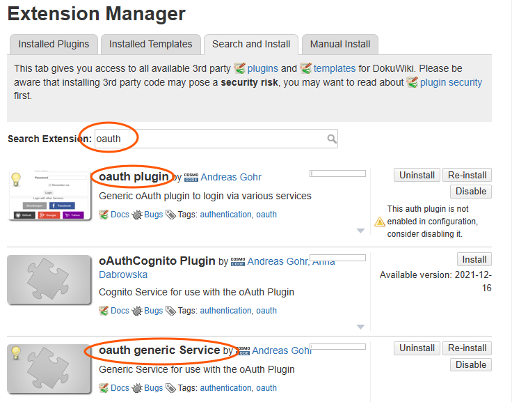

- At the Relying Party (RP) - MediaWiki in our case - install the extension to support OpenID login.
- MediaWiki needs to be configured in the
LocalSettings.phpconfig file.- Copy the discovery URL into the 'providerURL' setting

OpenID Connect login in MediaWiki is provided by the "oauth plugin" and the connected "oauth generic Service" extension.
After installation it can be configured in MediaWiki's Configuration Settings, near the bottom in the “Oauth” and “Oauthgeneric” sections.

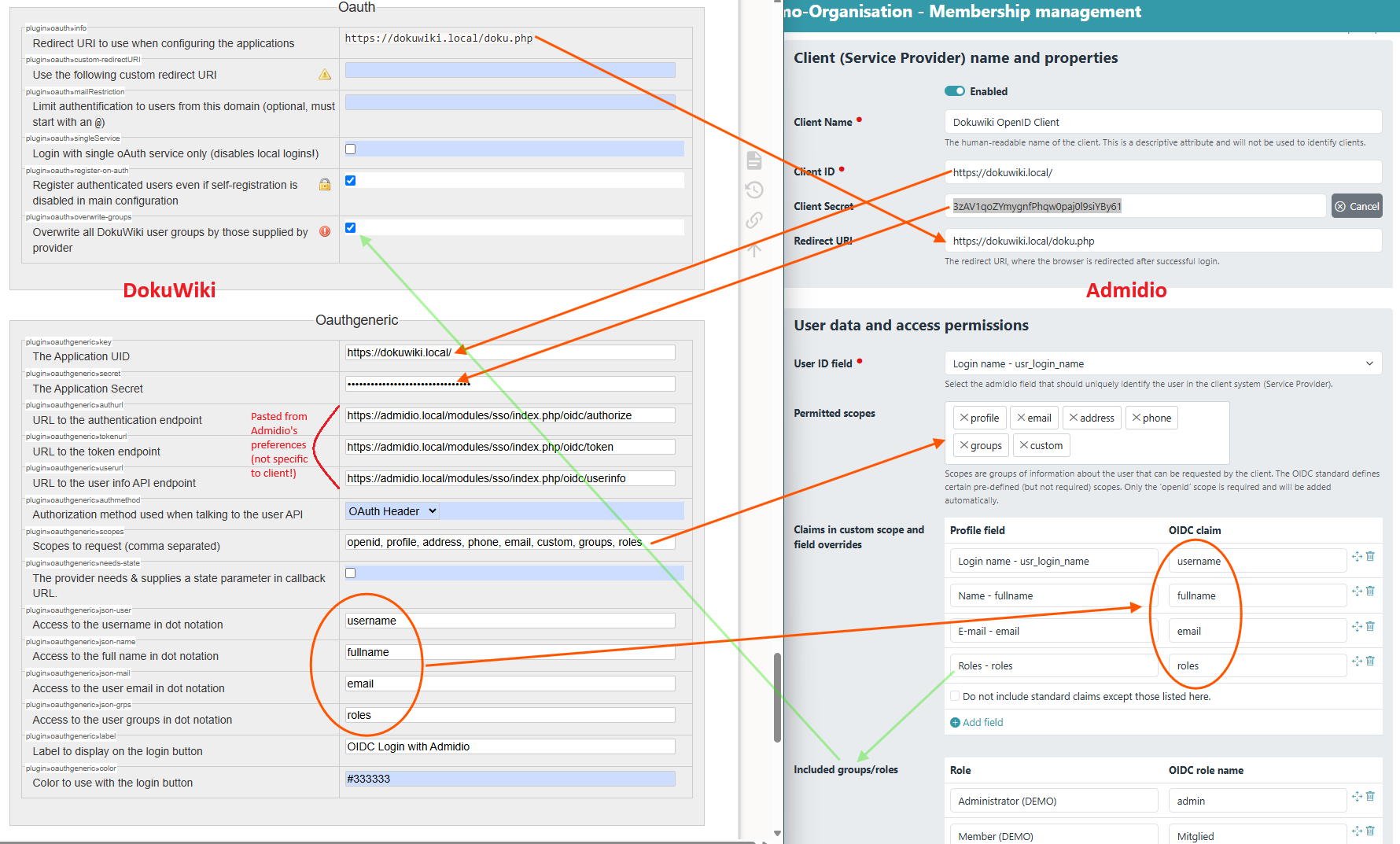

First, one has to copy over the OpenID endpoint URLs from Admidio's OpenID preferences (each URL has a copy button). You can find them here:
It is now a good idea to keep two browser windows open so one can easily select and copy the settings. Admidio even provides little “copy” buttons/icons to copy the various settings to the clipboard for easy pasting into MediaWiki's configuration.

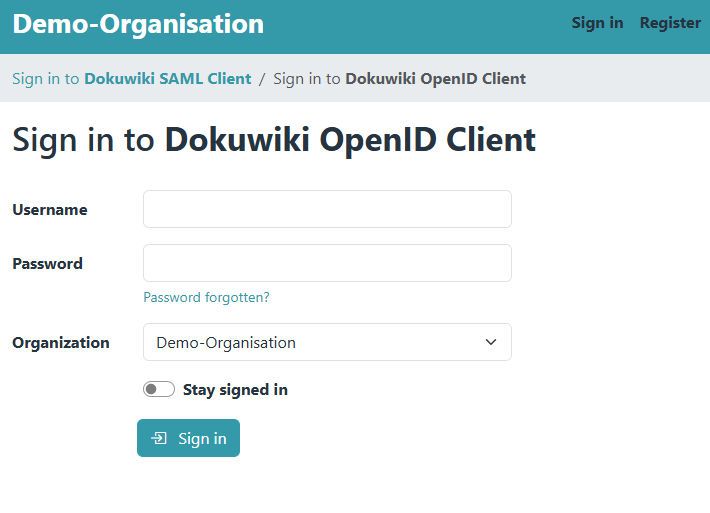

Now, return to Admidio's SSO preferences page, go to the “Single-Sign-On Client Administration” (the button right below the endpoint URLs and above the “Save” button), and create a new client.
- The Client Name is the label of the client in Admidio's client list, it can be anything you like.
- The “Client ID” and “Client Secret” in Admidio have to match exactly the “Application UID” and “Application Secret” in MediaWiki's configuration. The ID is typically the client's URL, although some clients allow any unique identifier, while others (most notably MediaWiki) require it to be the base of the OpenID endpoint (up until the 'index.php/oidc/'). The Client Secret should a random string and will serve like a password. Admidio will create one and allow it to be copied to the client. Afterwards it is only stored as a hash in the database and not be recovered any more. However, one can create a new Client Secret in Admidio and copy that to the client's configuration.
- MediaWiki will display its Redirect URL, which needs to be copied to Admidio.
- Enter the scopes you desire in MediaWiki's config and make sure that Admidio's config matches it. At least openid must be included (Admidio will implicitly add it). If groups/roles are supposed to be used for access permissions, the “groups” scope also must be included in both MediaWiki's and Admidio's scope setting and the roles included as an OpenID claim. (The groups mapping that Admidio offers is optional, one can also send all groups verbatim without mapping. This can be achieved by checking the checkbox below the mapping table in Admidio).
This is a typical configuration of the MediaWiki Oauth extensions for Admidio as an OpenID provider:
To use Admidio's group memberships as MediaWiki groups, make sure to include the “Roles” field and provide the correct field name in MediaWiki. MediaWiki even provides a setting to overwrite all groups with the groups received from Admidio.
Make sure to use the same OpenID claim names as the ones mapped in MediaWiki's OpenID configuration (circled red in the configuration screenshot above).

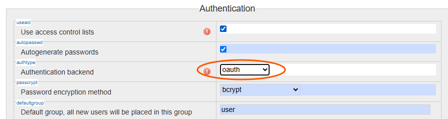

Once all settings are done, it is time to enable the saml plugin for login to MediaWiki in the “Configuration Settings”:
MediaWiki configuration as text
The settings done above in the graphical interface could also be done in the conf/local.php config file of MediaWiki. The corresponding settings would look like this:

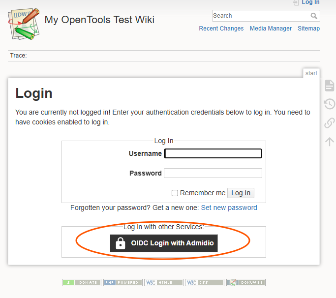

$conf['authtype'] = 'oauth'; $conf['superuser'] = '@admin'; $conf['plugin']['oauth']['register-on-auth'] = 1; $conf['plugin']['oauth']['overwrite-groups'] = 1; $conf['plugin']['oauthgeneric']['key'] = 'https://mediawiki.local/'; $conf['plugin']['oauthgeneric']['secret'] = 'lWDQ......gU'; $conf['plugin']['oauthgeneric']['authurl'] = 'https://admidio.local/modules/sso/index.php/oidc/authorize'; $conf['plugin']['oauthgeneric']['tokenurl'] = 'https://admidio.local/modules/sso/index.php/oidc/token'; $conf['plugin']['oauthgeneric']['userurl'] = 'https://admidio.local/modules/sso/index.php/oidc/userinfo'; $conf['plugin']['oauthgeneric']['scopes'] = array('openid', 'profile', 'address', 'phone', 'email', 'custom', 'groups', 'roles'); $conf['plugin']['oauthgeneric']['json-user'] = 'username'; $conf['plugin']['oauthgeneric']['json-name'] = 'fullname'; $conf['plugin']['oauthgeneric']['json-mail'] = 'email'; $conf['plugin']['oauthgeneric']['json-grps'] = 'roles'; $conf['plugin']['oauthgeneric']['label'] = 'OIDC Login with Admidio';

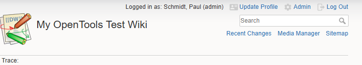

Admidio and MediaWiki should now be set up to use Admidio for logging in to MediaWiki. If you log out of MediaWiki and try to log in again, you will be shown the Admidio login screen and then redirected back to MediaWiki.
- MediaWiki allows admin login through OpenID by assigning the group 'admin' in the group mapping.
