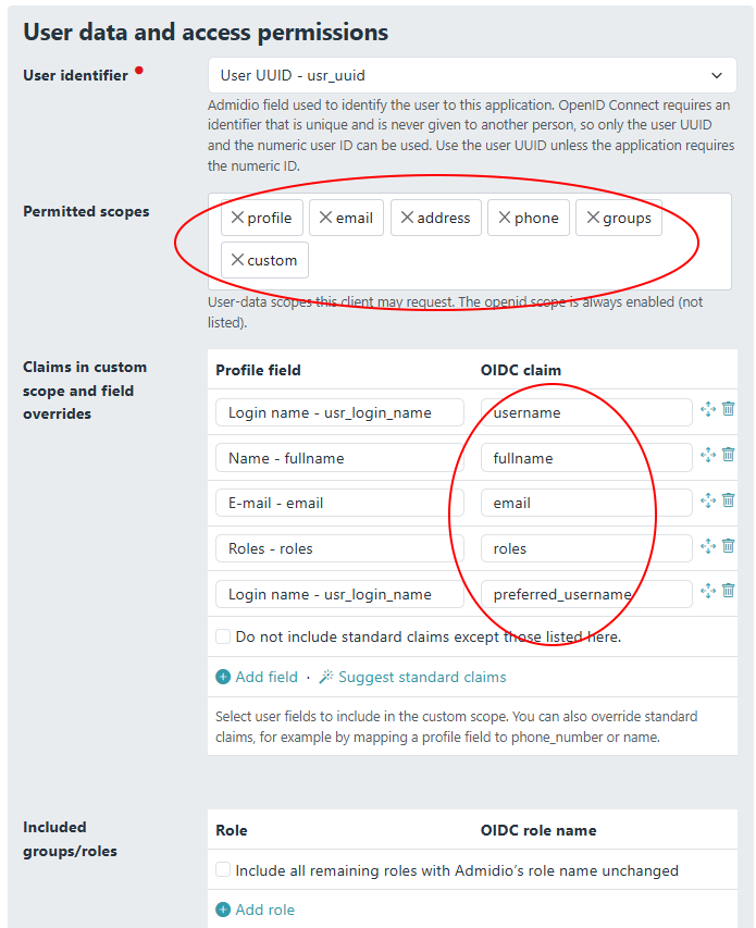

  4. Enter the scopes you used in MediaWiki's config and make sure that Admidio's config matches it. At least openid must be included (Admidio will implicitly add it). If groups/roles are supposed to be used for access permissions, the “groups” scope also must be included in both MediaWiki's and Admidio's scope setting and the roles included as an OpenID claim. (The groups mapping that Admidio offers is optional, one can also send all groups verbatim without mapping. This can be achieved by checking the checkbox below the mapping table in Admidio).
This is a typical configuration of the MediaWiki OpenID client in Admidio:
The clientID and the client secret in the Admidio client page and MediaWiki's LocalSettings.php have to match exactly. Similarly, the scopes should coincide, otherwise not all desired profile fields will be transmitted. To make use of the group mapping in MediaWiki, make sure to include the 'groups' scope in Admidio and Mediawiki, and map the 'Roles - roles' Profile Field to an OIDC claim.
