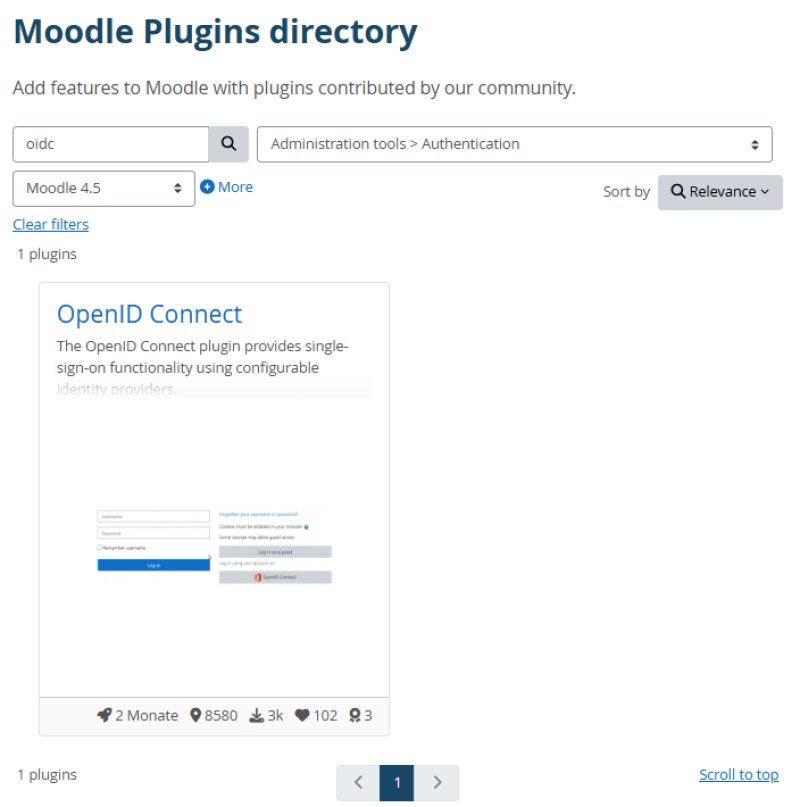

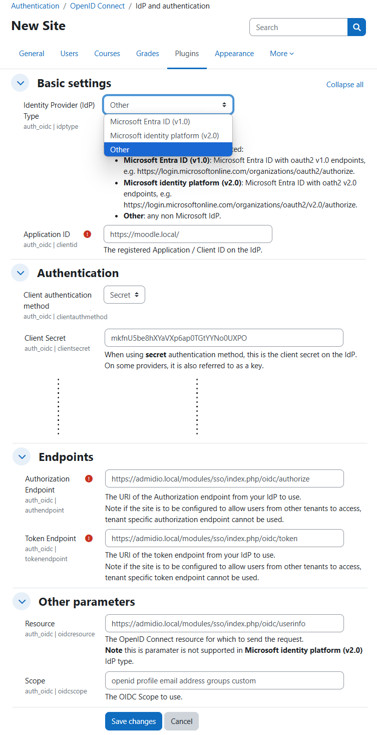

First, install the OpenID Connect (auth_oidc) app in Moodle from the plugin directory:
  • After installing this plugin, go to the plugin list and scroll down to the „Authentication“ section (or alternatively, use the URL https://[YOUR_MOODLE]/admin/settings.php?section=manageauths). The OIDC plugin should be shown together with a link to the settings.
  • Go to the plugin's settings (either via the link in the plugins page, or in the menu item „Plugins“ → „Authentication“ → „OpenID Connect“).

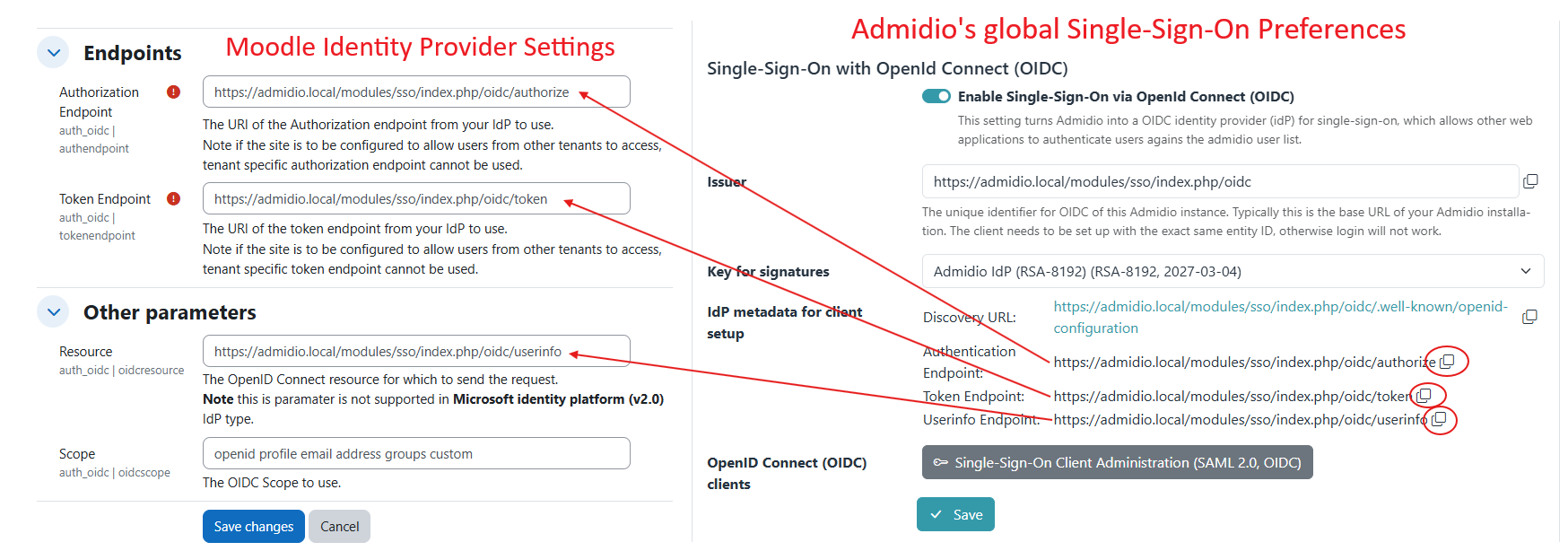

  • The most important section is „IdP and authentication“, as it configures all endpoint URLs to talk to Admidio. The „Identity Provider (IdP) Type“ is „Other“, the Application ID is OpenID's RP ID. It can be freely chosen, but should uniquely identify the moodle client.
  • It is now a good idea to keep two browser windows open with Admidio and Moodle's configuration so one can easily select and copy the settings. Admidio even provides little „copy“ buttons/icons to copy the various settings to the clipboard for easy pasting into the Moodle configuration.
  • Go to Admidio's Single-Sign-On Preferences and copy the endpoint URLs for OpenID (Authentication, token and userinfo endpoints). They should be pasted into Moodle's Client configuration as „Authorization URL“, „UserInfo URL“ and „Token URL“.

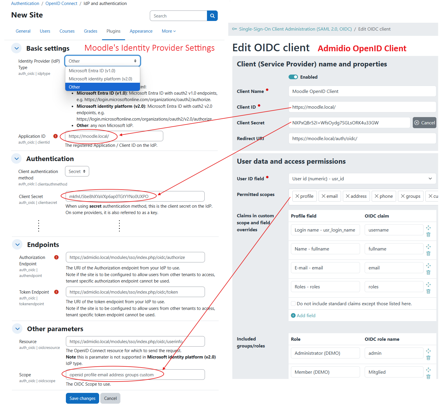

The next step is to set up Admidio to receive login requests from Moodle. This is done by adding an OpenID client in Admidio.
Return to Admidio's SSO preferences page, go to the „Single-Sign-On Client Administration“ (the button right below the endpoint URLs and above the „Save“ button), and create a new client.
  • The Client Name is the label of the client in Admidio's client list, it can be anything you like.
  • The „Client ID“ and „Client Secret“ in Admidio and Moodle have to match exactly. The ID is typically the client's URL, although some clients allow any unique identifier. The Client Secret should a random string and will serve like a password. Admidio will create one and allow it to be copied to the client. Afterwards it is only stored as a hash in the database and not be recovered any more. However, one can create a new Client Secret in Admidio and copy that to the client's configuration.
  • Moodle's OIDC plugin does not support PKCE, so it must be disabled for the OIDC client in Admidio to prevent errors.
  • Enter the scopes you desire in the Moodle config and make sure that Admidio's config matches it. At least openid must be included (Admidio will implicitly add it). If group support is desired, the „groups“ scope must be included (and the corresponding groups claim mapped, and group support selected in the Moodle config).

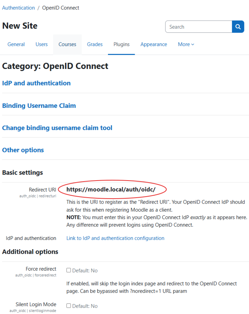

Now save the Identity Provider Settings in Moodle and return to the general OpenID connect settings of the plugin (https://[YOUR_MOODLE]/admin/category.php?category=oidcfolder).
  • Moodle will display its Redirect URL in the „Basic settings“ section that must be entered in Admidio's settings. Enter this URL in Admidio.

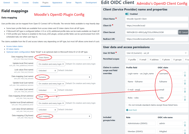

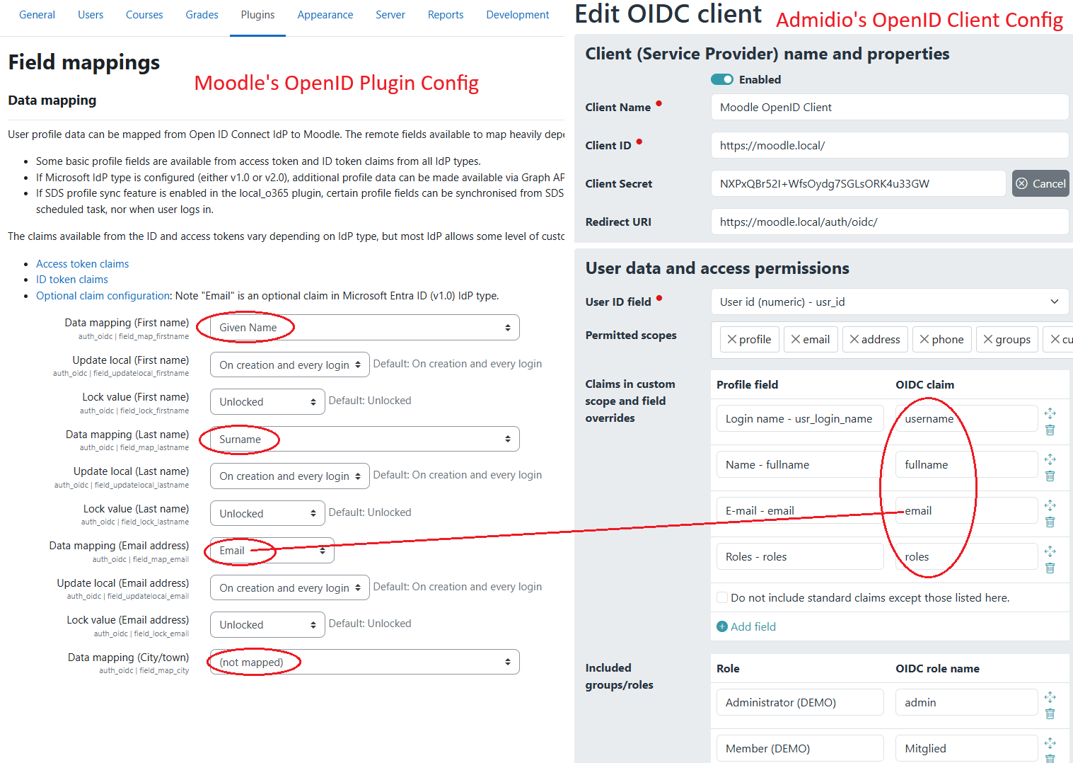

OpenID Connect logins can transfer Profile field information from Admidio to Moodle, but this needs to be set up. In general, OpenID does only include the user identifier, but no other personal information. To allow individual pieces of profile data (a „claim“ is one profile field), OpenID groups them into „scopes“, which are groups of profile fields, like „profile“, „address“, „phone“, „groups“, … Each of them allows access to some defined claims. In the Identity Provider Settings the scopes that are requested from Admidio can be configured.
However, Admidio also needs to be configured to map its profile fields to the defined OpenID claims.
  • In Admidio, choose which field should be sent to and used by the Moodle Plugin to uniquely identify users. This would typically be the login name, although the user ID or UUID area also possible.
  • In Moodle's OpenID plugin config, go to the „Fields mappings“ section, where the OpenID claims can be mapped to Moodle's fields like „First Name“, „Last name“, „Email address“, etc.

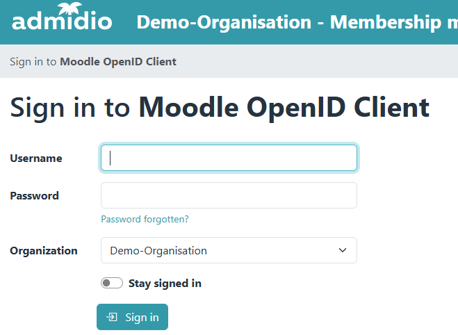

Admidio and Moodle should now be set up to use Admidio for logging in to Moodle. If you log out of Moodle and try to log in again, you will be shown the Admidio login screen and then redirected back to Moodle after a successful login.

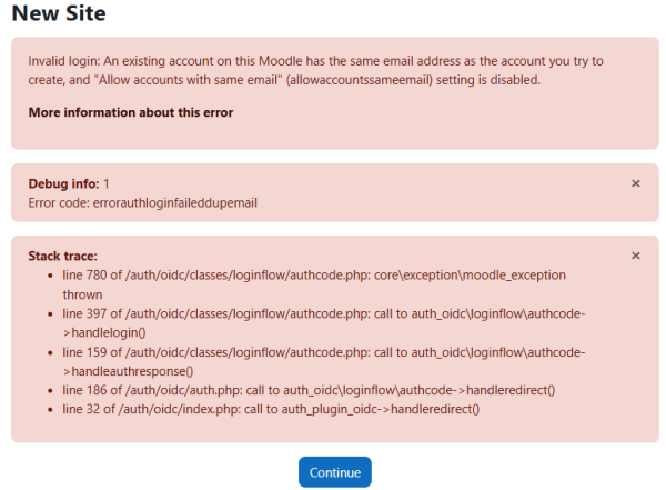

  • If you have user accounts from different backends (e.g. local accounts, OpenID Connect login, SAML login) and an account for a user was already created, Moodle tries to match accounts by username (the field selected in the plugin config). However, if the other account has the same email address, but a different user ID through the SAML or local backend, Moodle will try to create a new account with the SAML user ID, but fails since another account with the same email already exists.
