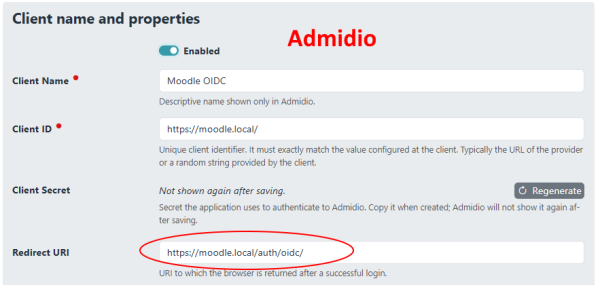

Return to Admidio's SSO preferences page, go to the “Single-Sign-On Client Administration” (the button right below the endpoint URLs and above the “Save” button), and create a new client.
  • The Client Name is the label of the client in Admidio's client list, it can be anything you like.
  • The “Client ID” and “Client Secret” in Admidio and Moodle have to match exactly. The ID is typically the client's URL, although some clients allow any unique identifier. The Client Secret should a random string and will serve like a password. Admidio will create one and allow it to be copied to the client. Afterwards it is only stored as a hash in the database and not be recovered any more. However, one can create a new Client Secret in Admidio and copy that to the client's configuration.

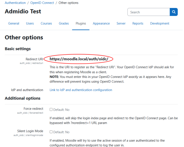

Now save the Identity Provider Settings in Moodle and return to the general OpenID connect settings of the plugin (https://[YOUR_MOODLE]/admin/category.php?category=oidcfolder).
  • Moodle will display its Redirect URL in the “Basic settings” section that must be entered in Admidio's settings. Enter this URL in Admidio.
  • Most of the other options can be used for fine-tuning, but in most cases do not need to be changed.
