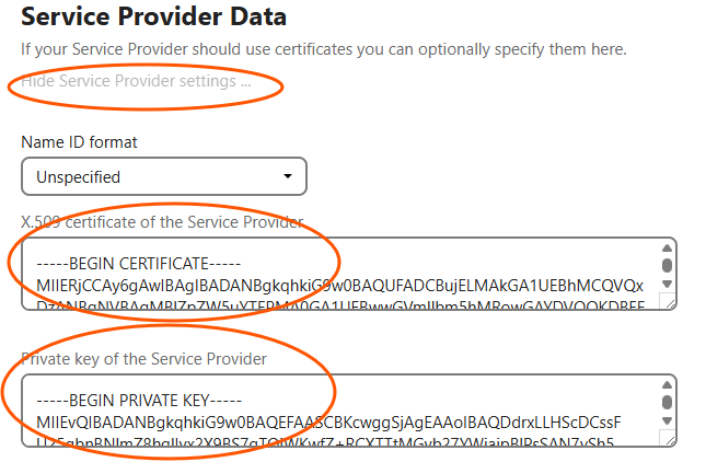

Setting up encryption
If encryption is desired for all SAML messages sent by Admidio to Nextcloud, or if Nextcloud should sign all its requests, then Nextcloud needs a private/public key pair to decrypt or sign messages. These need to be entered into the Nextcloud SAML config in PEM format and can be generated by openssl's command line tools, by tools like https://www.samltool.com/self_signed_certs.php, or in Admidio's key administration. Simply create a new Key for Nextcloud (RSA 2048 bits). The certificate can be copied directly from the key's edit page, but the private key is not available in Admidio's GUI for security reason. Instead, it can be downloaded (secured with a password!) from the list of keys in Admidio:
After downloading the .p12 file, Applications like KeyStore Explorer can be used to read the private key and copy the private key and the certificate in PEM format to the clipboard and paste it into Nextcloud's SAML configuration.

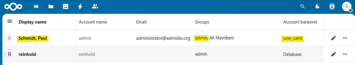

Admidio and Nextcloud should now be set up to use Admidio for logging in to Nextcloud. If you log out of Nextcloud, you should see the login screen with the choice of logging in with password or via SAML.
  • For security reasons, Nextcloud will prepend SAML_ prefix to the group names obtained from the SAML IdP. This makes hybrid environments quite hard in practice, where some users authenticate via SAML, others via local accounts or other network accounts. In these hybrid cases, the SAML-generated groups will be different than the local groups and all group permissions need to be set twice! As a workaround, one can enter a single space into the prefix input box. This will cause Nextcloud's SAML extension to clear the prefix, but the input field will appear empty in the future, so it is not clarly visible whether the prefix was „cleared“ or the default prefix will be applied!
